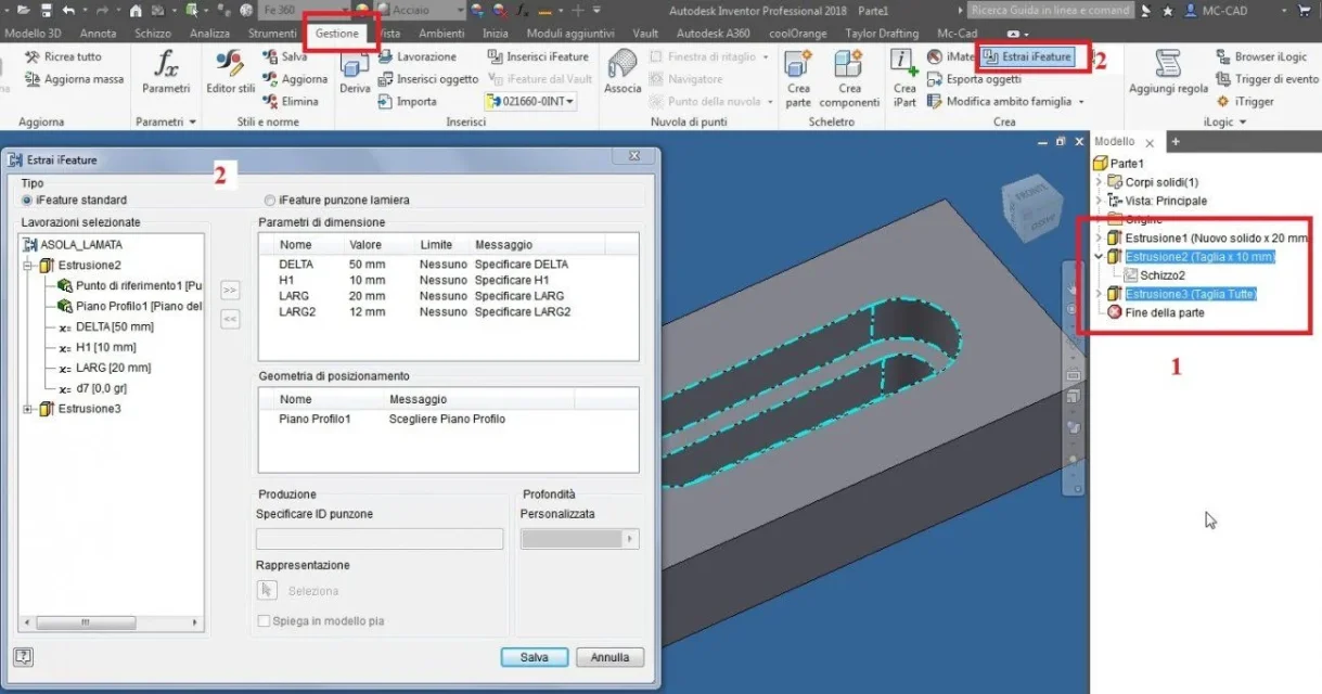

In reality it is possible to create any form, through the management of the ifeatures.
each footprint can be grouped into a single processing associated with a "punzone" recallable at any time. There are also punches for sheet metal
in this case:

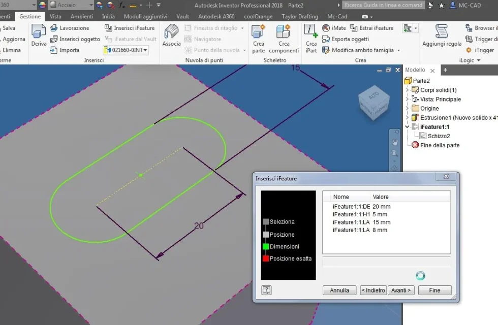

1- draw the desired shape through extrusion processing_foto__145.webp2- by management => estrai ifeatures, save the "punzone"

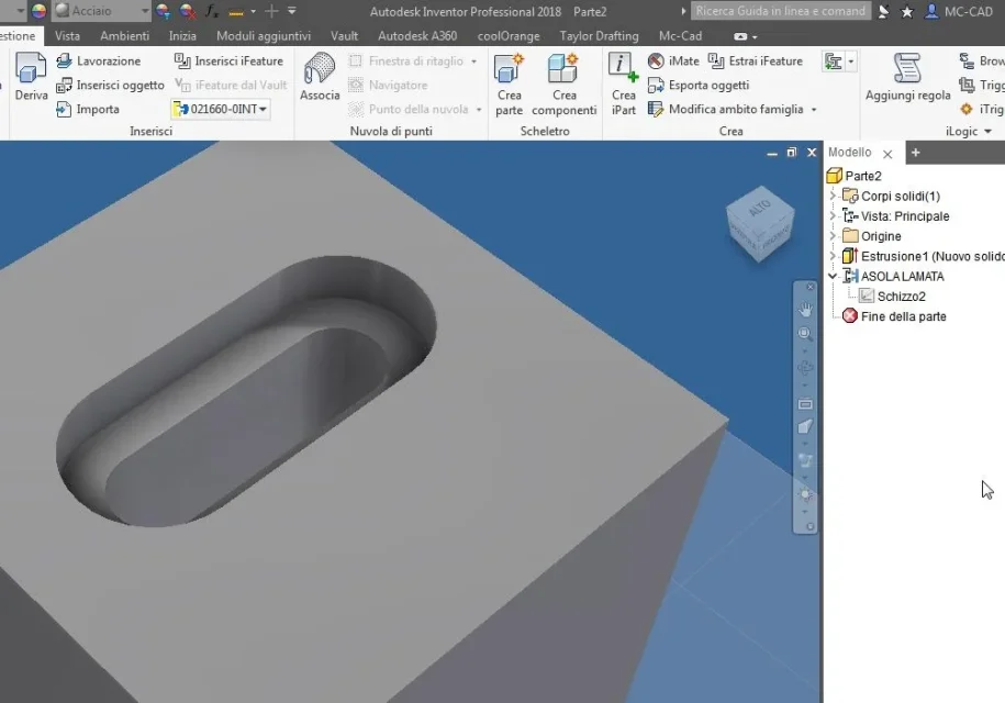

3- in each part, it is possible to recall the punch and associate it with faces, entering the values via interface_foto__143.webpresult:
