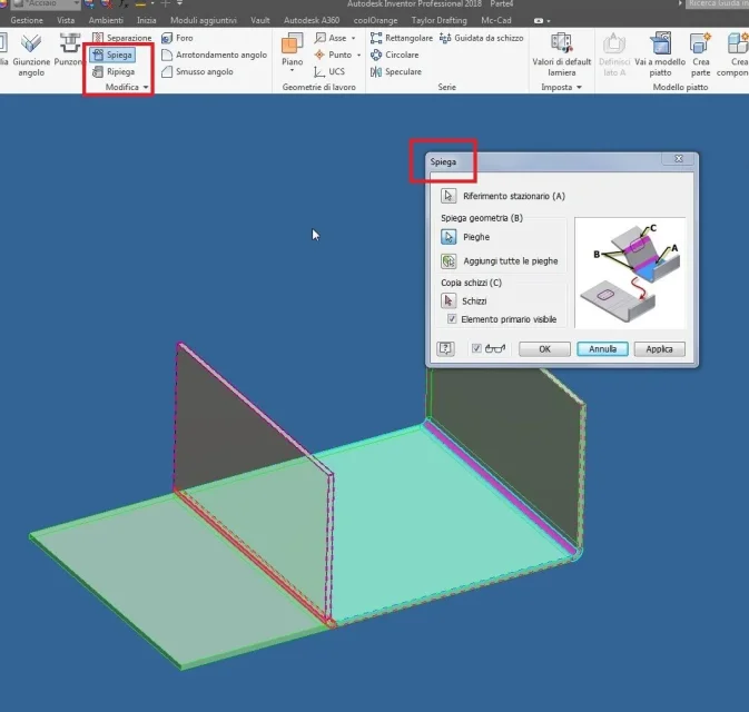

if possible, make a hole and then a polar series
I would not like to use the sheet module besides I can not use the polar series because the holes are high from the flange and almost all different angles.
