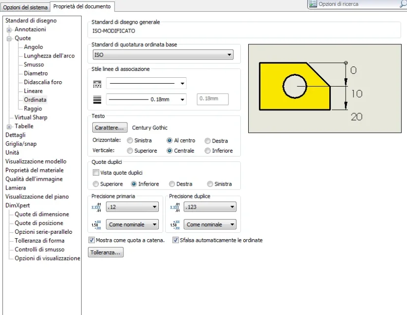

as you can see from the image
quote ordinata orizzontale.webpin sketch environment I have a series of quotas on the horizontal order in which the text is placed on the quota line. I tried to move the reference share to the other extreme of the sketch and move the connection point as well as to turn off with the options to place it on the outside at least above the quota line but without result because I fear they concern the table setting (although changing other parameters on the type of arrows etc is also modified the sketch).
place also a screenshot of the quota settings.proprietà quotatura ordinata.webpif I create a new part the odds are correctly placed outside the quota lines.
Any ideas?

those of the screen should only concern the settings of the part

However just opened the sketch showed me as from image. Immagine.webpI would do this, if you haven't already done it, just to remove some stone from the shoe; achtung, I'm not in test order, but how they come to mind:
-Save model settings where the order works and import it into the kissed one
-close all the barrel, even the pc, so that it resets all the memory and reopens (you've never seen that it is a moment of senile dementia of the software)
-(if you have it at your disposal) open the file on another pc
-expand the image quality of the document properties to the maximum
I don't know what else to tell you right now.
I don't have another pc on which to try and the maneuvers with the change of resolutions are not served. I exported from the file that worked the quotation settings in the sldstd file and reimported them in the "corrupt" file without result.
I can also live with the odds cut by the quotation line but the bales are spinning that you can't understand what it depends on.
