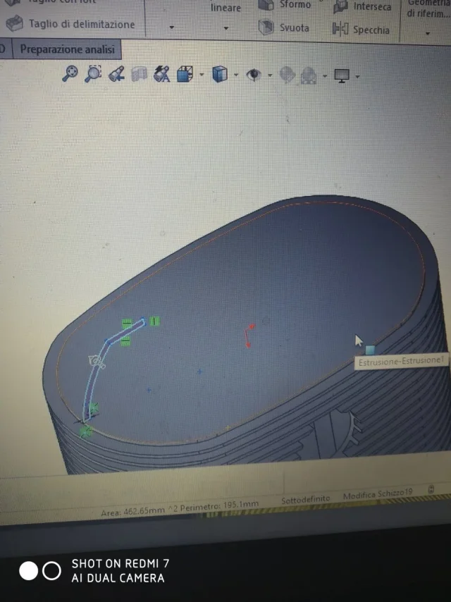

without file, without property manager, without model image with sweep it is impossible to answer.what gives me something is extrusion with sweep that in the fittings I get stuck

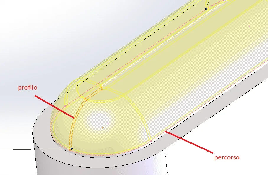

Yes exactly, it is he, but it does not make me select more than a piece of curve in the sweep extrusion, but I do not have straight parts and I have 4 fittingsMaybe you want to do something like this?
because the path asks only one element (the input box is single) then you have to do a sketch of the pathit does not make me select more than a piece of curve in the extrusion with sweep, but I do not have straight parts and I have 4 fittings
and this from an image should be understandable?But I have no straight parts and I have 4 fittings

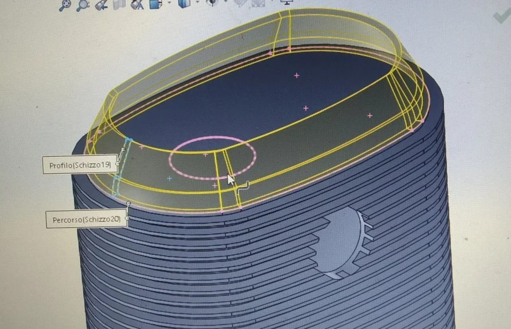

If you look at my sweep you will see that the radius tightens, this means that beyond a certain geometry the radius cannot be done and consequently by error.Maybe with the geometry that I had, I don't know what
I understand, thank you, the curved part I do so with the sweep, while the straight part I do it with basic extrusion so it does not generate any error. to me he only said "mistake in reconstruction. completion of the unsuccessful sweep operation" a little generic.If you look at my sweep you will see that the radius tightens, this means that beyond a certain geometry the radius cannot be done and consequently by error.
error that if you are reported you have to report in the question otherwise you cannot understand what generates it.
