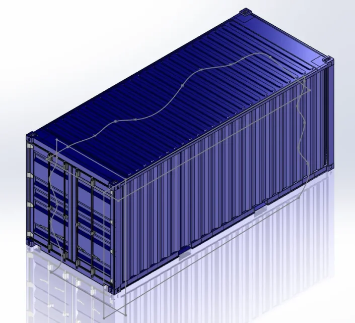

hi guys, I have a container found on the net, made with infinite number of surfaces ... to cut to show the content ...
I tried with some methods, but I can't solve, would you give me a hand, a suggestion?
I attach the model with the 3 sketches that serve to cut into the inside of the box.
I'm killing myself on something like that.
use short/wire command
from toolbar > trim surface
by menu functions>superfici>accorcia
but do not use extruded bodies, but sketches
consider that many surfaces, those completely inside the sketches, you will have to delete them by hand

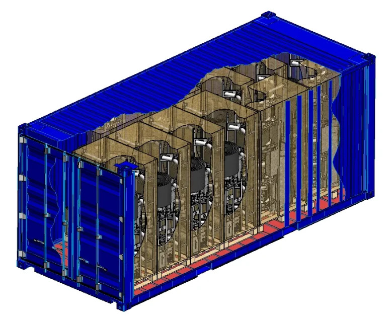

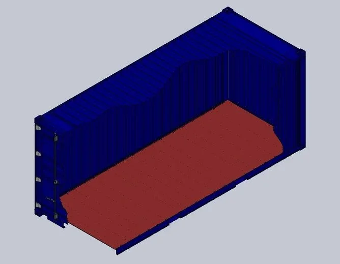

Hi, it came better to tea!
... to me there are several surfaces...
do you have a method to select all surfaces (or bodies) and tell them that they are only to be suspended for this configuration?
look to clear the surfaces I didn't take more than 10 minutes, keeping me wide.
