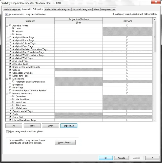

go to visible/graphic replacement in the properties of view > annotation objects and pick up the item "section"
I looked, if it was the right place, since I installed the English language...
You say in the menu "visibility/graphics overrides" right?
but I had looked and the voice "sections" under annotation categories the tick was and there is. (see image)Sections.webpHowever, the spuns are missing on "elevations" and "automatic sketch dimensions". (see image)Elevations.webpI tried to uncheck on "sections" and then put it back but nothing.

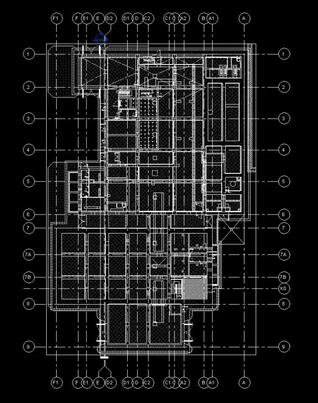

Perhaps it can be interesting that you see only one line of section that I have stuck on another table. (see image)Pianta.webpah.... I also hid the reference plants that I had imported from autocad, and also those I can not see in these plants.

what scale was your plant set? revit does not show the section symbols for the stairs (superior to 100) from 200 up to enough to understand us (at least to say from 101 up).
