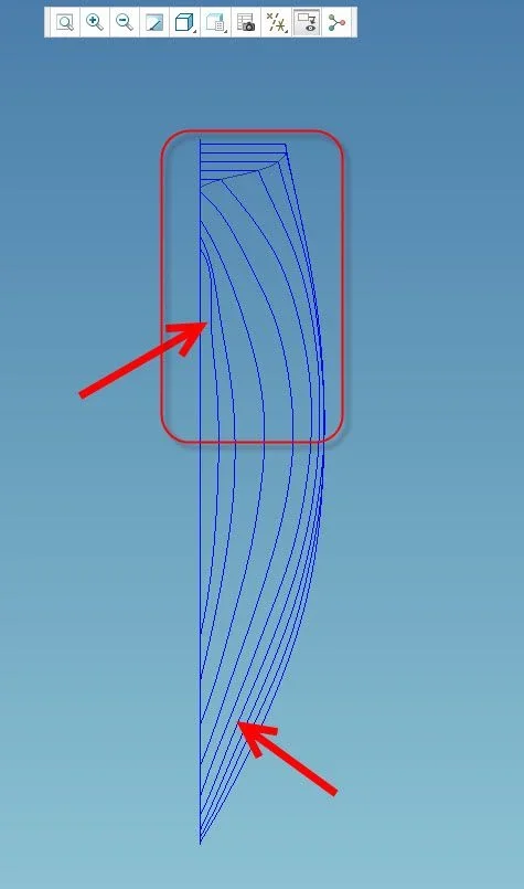

hello max, obviously criticism was not addressed to you.
the order curves and the waterlines have flex points that I consider unacceptable for a hull that should be well done.
In my opinion, if it's an existing boat, the data that you've been through doesn't reflect reality.
thanks to the help of the always available maxopus, I made the plan of construction following the detector.
the result is that of the attached images.View attachment 38096View attachment 38097View attachment 38098
I don't understand. Is there anything wrong?

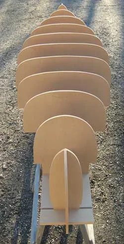

as mentioned above (some post before..) I look from vs. American colleague who sends me the "half model" to among other things tells me that: <gino 1="" 2="" 3d="" am="" as="" be="" cad="" can="" carve="" drawings="" familiar="" for="" from="" generated="" hull.="" i="" international="" into="" look="" model="" molds="" not="" patient="" please="" shipping="" shipping.="" the="" tim="" to="" used="" while="" with="">If I have well understood, in addition to the artifact, I attach the or 3d files from where I can extract the sections for the centines etc. etc.
In practice I should be able to have something like this:</gino>3d.webp- to cut the order of the type:uno.webp Anyway, as soon as I get everything, I'll get you the files for a comparison.
No, I don't think there's already a boat.
I'll have the files for a comparison.</gino>
Okay, with data 3d we'll understand better where the problem is.
max1947, the problem is and is evident.
I'll only avoid the most exclaimed.
It is clearly seen that the curves of the water lines do not have a "regular" pattern but have some flexes that should not be there.
the solution exists and is to change the wl until it has a regular surface, well smooth to understand, and then, "cut" the same transversally to get the ordered reals. but so, we will have a slightly different hull than that of the project.
We wait as maxopus says the 3d and then we see.View attachment 38109View attachment 38110
Okay, thanks to both of us and we'll be back when I get the files.

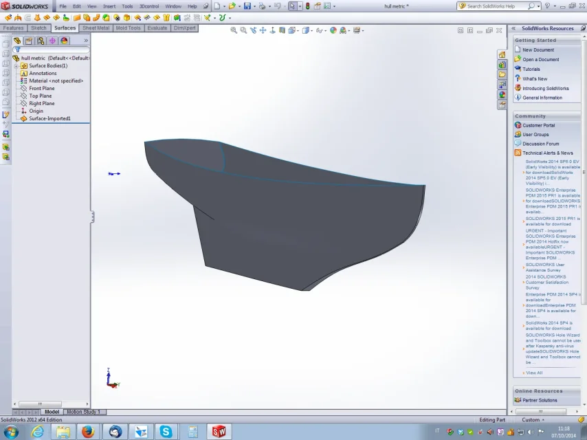

open with solidwrks. I'll rearrange it in iges format (I'm sure your supplier agrees to put these files to despotion of the world? ).
Thank you, I see you added to the puppy.
I didn't think about what you said. I hope it stays in the narrow current circle.
OK max, I opened it without problems. As soon as I have a moment, I'll take a look. .07-10-2014 13-09-06.webp
I've made two tests so dismissed with exports, and subsequent imports into formats that have not yet been appointed.
I attach the result::tongue:
I apologize for the delay but I had to finish a job.
this is the building plan obtained from the 3d.
I expected good new ones and... they arrived!. a big thank you and all the company, I had what I was interested and so besides thanking you again in a particular way, and others, I close the discussion. If everything goes to port, I'll get you my news. Thanks again and good work and...good wind to all.:finger::smile:finger:
