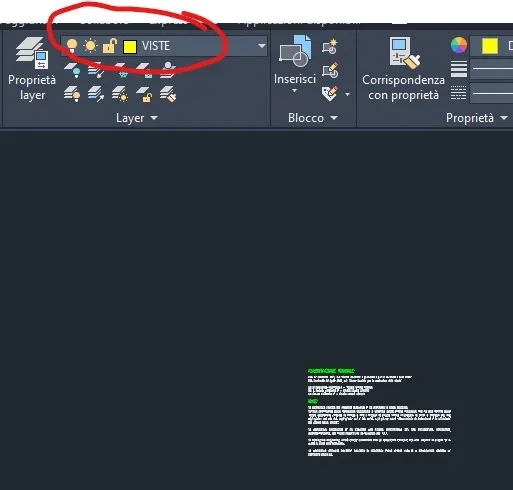

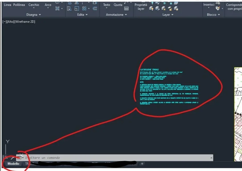

i don't see the writings in the layout
  • Thread starter Thread starter Alex97
Alex97
I entered a text copied from another file, in model space, then went the loyout but you can't see, I checked even if the layer was frozen instead no, I tried to change even layers but you can't see, what can I do? I also tried to insert the text in the layout pane and you don't see it in the layout but I see it added in the model space, what can I control?

but the layer on which the text lies, within the layout window, is thawed?
control the column "freezing window" in layer management recalled from the inside of the window in the layout.
or may be that the text is annotative and the layout set with a scale not included in the text
