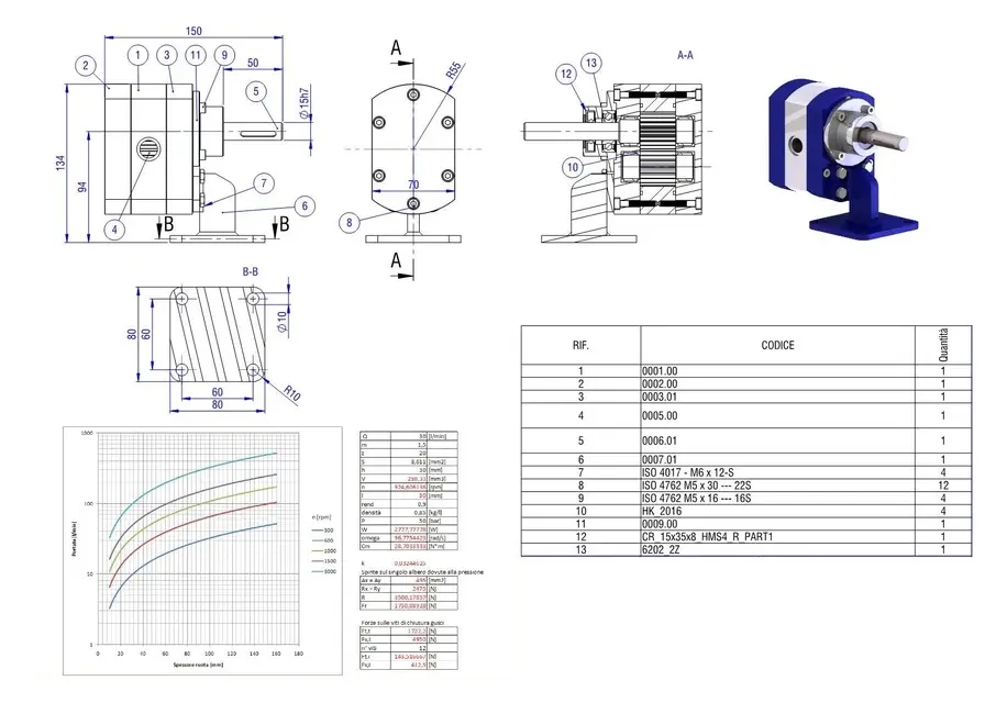

lapa inggranagi a fixed capacity It is very simple to build and follows quite simple laws. I train you what I built
Are you crazy? !:eek: (in the positive sense)
However, I suggest you insert the compensated bushings, you are still "remained" to the old type of construction:biggrin:

Let's do something simple: If you can, take a picture of your system so we can figure out a little better.
among other things I am also convinced that you are confusing the external gear pumps with the internal ones.:tongue:
to answer your question: make ad hoc a pair of gears to fit your needs will cost you at least as much as a new pump. If we talk about micro pumps (pompe group 0.5...the family of pumps dedicated to the control units) you can well take it with max 50€.
maybe here you could find something that does to your case:
http://www.vivoil.com/it/indice-prodotti/pompe-unidirezionali/
http://www.vivoil.com/files/vivoil_p_it.pdfother pump manufacturers are:
house, salami, sauer danfoss, Marzocchi, hp (group bondioli&pavesi), oleodynamic petrone, meta, etc.
edit: ....forget "only" the world leader: bosch

These are external gear pumps but adapted to work immersed in the oil all together with the engine.
to cut short I decided to proceed with the construction of the pump, you know some company that produces gears beyond meves, microengines, moreali....thanks you
you can build a multi-stage pump or increase the flow or pressure depending on how you connect the travases or if you want larger flow rates and you have a low gear module increase the b band of the same.
I think the matter is easier than what you think without having to shake up internal gears. all gear builders you find on white pages like ceba and others.
multistage pumps i.e. centrifugal multistage? .I had never heard of volumetric multi-stage masses if not sometimes those in palettes also because the volumetrics already give high prevalences. ..mixed multistage are monsters then
