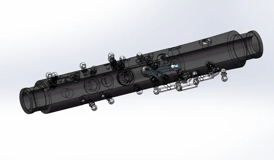

Hello! I place the image captured from my screen... I don't know what happened. That's what I see. practically if I press "f" the axieme zooms far away and I no longer see the model. I enlarge a particular... But here's what I see. I don't know what I did. I can't fix it anymore. It's a preble in the axieme because if I open the parts the visualization is as usual... I'm panicking, any ideas?

I think you clicked on "island", but without the fm it is impossible to help you.

You said that only from an image we can't understand what happened. you were asked at least to understand the imagefunction shaft the feature manager), to try to understand which commands I used.
If when you press f everything moves away/reflects you obviously have a small part "dispersed away in space". but so to nose is only a hypothesis, difficult to say. I'm posting the file we do before.

Yes I responded a bit wrong... But you know, I said I wanted something... However, I also think it's a part that's placed away from the axieme and for some reason the visualization went together. I've done everything for now. I didn't have time to search again... the thing that surprises me is that once the axieme is enlarged it is like this. It's like there's transparency or even a section displayed. I checked the fm but there's nothing out of place, like visualization. I have a picture fx 45000 and sw 2012 sp1 l'assieme unfortunately I can not post it.

some hidden sketch (or that is not displayed thanks to sketches) with dots scattered at altitudes kilometers?

Do you have sketches imported from dwg/dxf?
to me it happened with schetch created importing dwg where geometry was very far from origin. Cleaned the whole thing, defined the sketch and translated into the position I needed on the model, when adapting the view seemed to change solar system on the star trek ship and I returned to have the same visual as when I pressed f inside the imported dwg. . .
I never figured out how to fix it if I don't do the sketch from scratch. It seemed that he kept in memory the deception and the position of the dwg before the change.
he he he... you gave me a lot of ideas... Thanks! It was a sketch that wondered how she had scattered odds. Moreover a part because of a not totally defined coupling is ended far from the assieme. Yes, however, a slaughter find it and put it all right. the aid was saved in 2007. I haven't opened it since. taken to see details... After working with us, this happened. I found it by chance because if I was selecting it in the nan screen fm I saw it. If I asked him to zoom in on that part it magnified but I didn't know where he was positioned.
