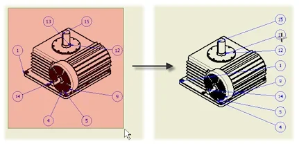

I am a few versions back but
recita:
window selection for aligned balloons
any window selection that includes balloons is valid, and displays align commands in the right-click menu. after you start an alignment command, all objects that cannot be aligned are automatically removed from the selection set.https://knowledge.autodesk.com/supp...840d9449-21b1-4049-9796-4c66042cbb24-htm.html
