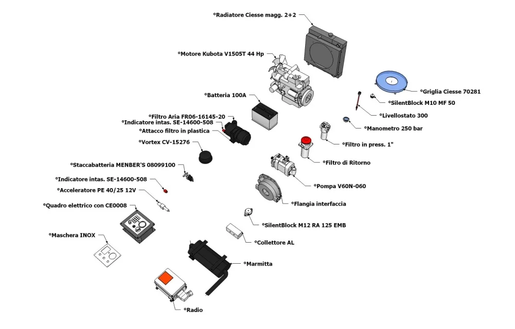

below you can see pieces I designed to design a hydraulic control unit.
I made them by measuring the real pieces that the customer wanted to use and drew them approximately where it was not needed but precisely in the areas where they were fixed.
some standard pieces you can find them already designed in 3d warehouse (https://3dwarehouse.sketchup.com)
