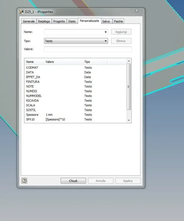

-"property tab name" are the cards (genral, summary, project, state, customized, save, physical)
- "property name" are the variables within the card.
e.g.
iproperties.value("custom", "thickness")
will give you as a result (see photo) 1 mm
