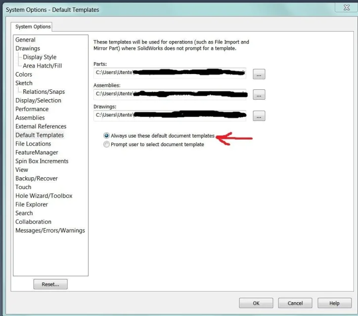

is it not that he asks you to confirm the default template?
If so, you must set up in options to always use the same template.
see screenshot
see screenshot
That's right. .
I changed the settings like you said...
It works. . .
thanks 1000:biggrin:
