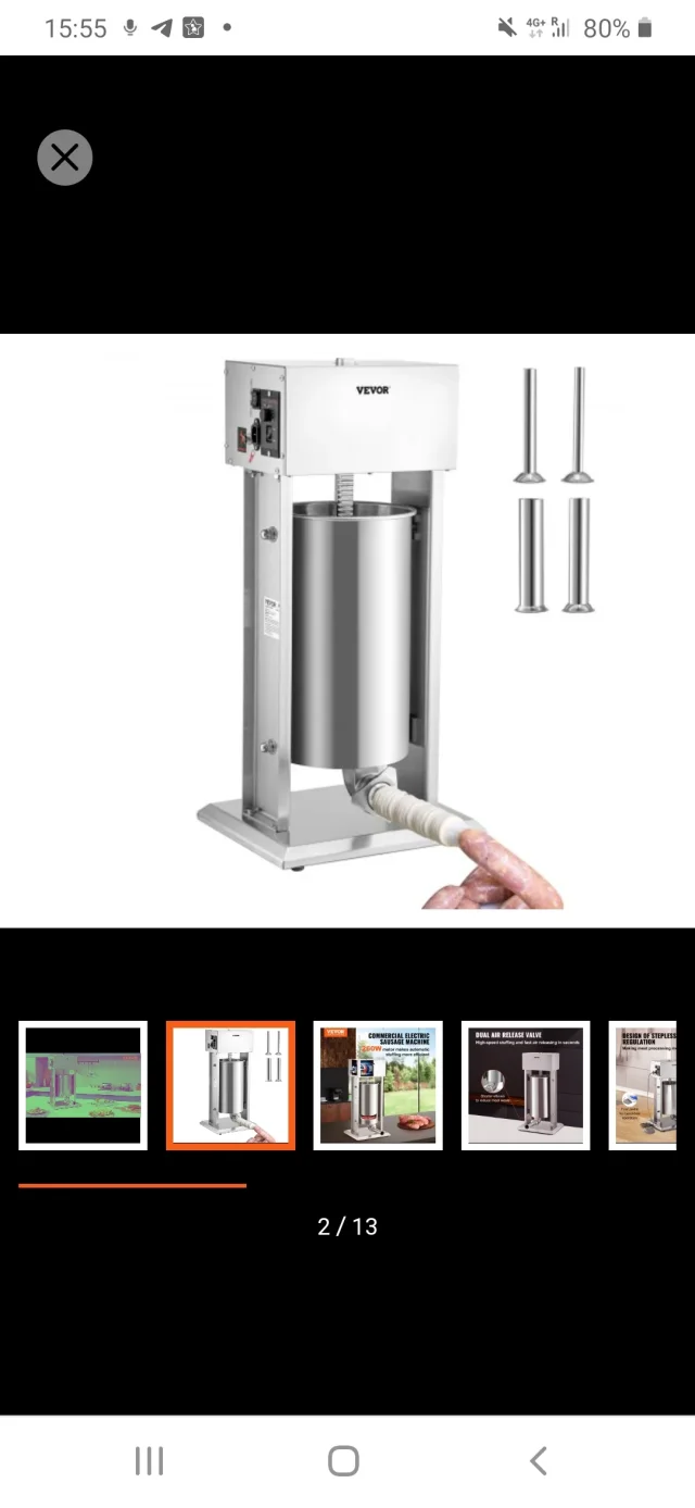

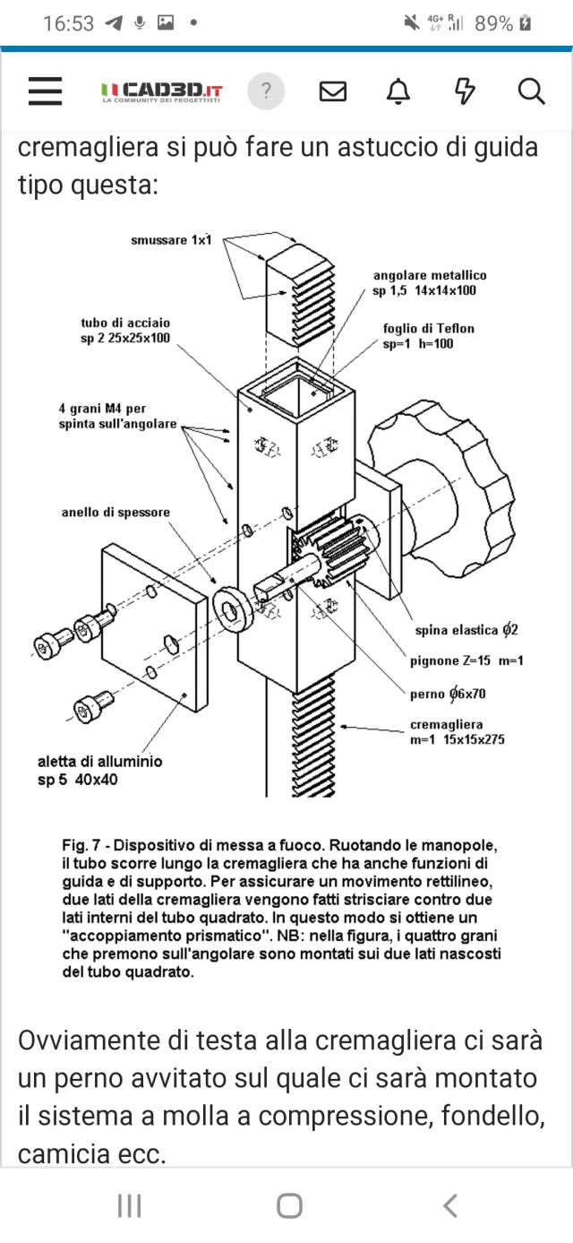

I repeat the thanks for your previous interventions. being the vertical development insulator I have to make sure that the piston goes down vertically and I thought of turning the rotary motion into a translatory through a rack that will be connected to the piston. the rack besides gearing the pinion as it keeps? Are there any guides to keep it on board? Are there any creeping seals or anything to prevent dust entry at the point where the rack comes out? Thank you.
I found a similar one to what I'm doing and the arm that pushes the piston I'm thinking of making it a rack. I attach the photo to make you understand what I meant before in case you didn't explain well.

I found this answer in an old question is also applicable to my case?
