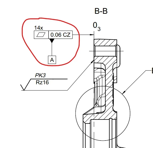

interpretation of localization tolerances
  • Thread starter Thread starter RDJ85
RDJ85
slave,
I wanted to ask if someone would be able to interpret the localization tolerance in the attached photo, specifically I do not hesitate to find feedback for the flatness cz and the location 0.1uz-0.05.

I also found it in a drawing made by the Indians who make mass table, put everything and more.... then to understand what it means to the braking operator who has the design in hand.... there is no see.
cz means combined zone.
that is the reference is to several separate surfaces that are part of the same tolerance.
iso 1101:2017 and later.
Screenshot_20240602_125837_OneDrive.jpgfor Uz read here:Screenshot_20240602_130446_Google.jpgdo first to get the norm and study it carefully.

View attachment 71384for Uz read here:View attachment 71385do first to get the norm and study it carefully.
More and more difficult... What a fairy!!
already....the beauty is that they are things that become impossible to verify, so they are only the chief puzzles who make pieces in series for very expensive sectors and who then always find the way to screw the supplier.
