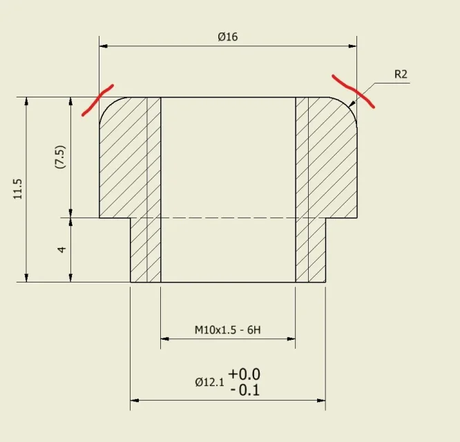

I haven't been using inventor for a while and have a couple of questions:
How do we eliminate overlaps of quota extension lines?

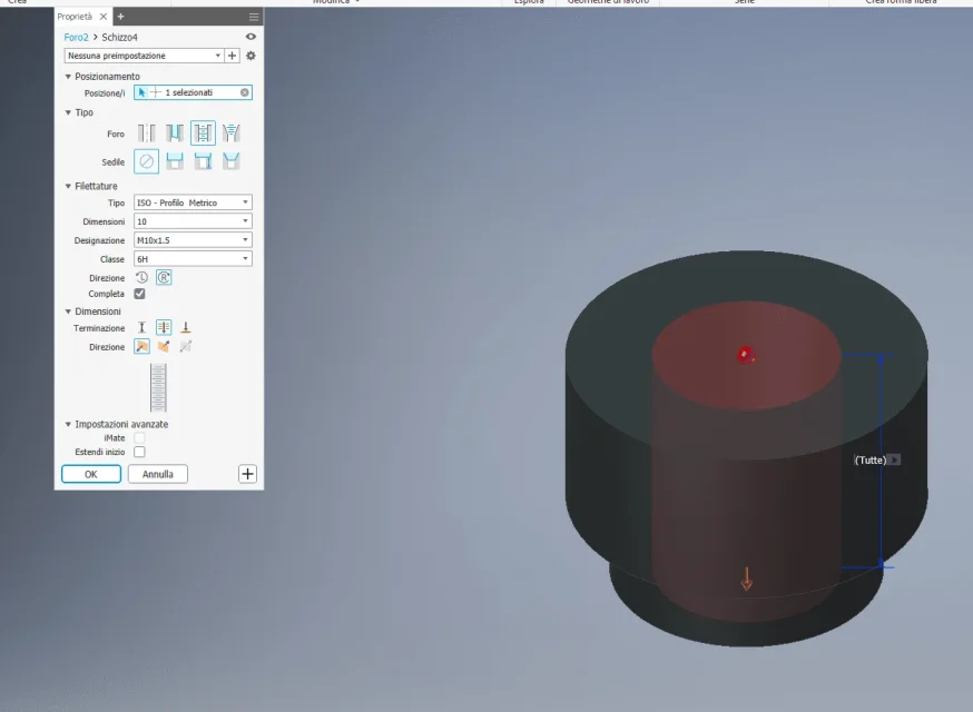

I made a m10x1.5 hole in the part, actually I wanted to make a m10 big step, is there any way to realize it? or should I change the drawing file settings?

enter the part, change the feature of the hole and you find the change even in the table.
no threaded hole, you have to point on the thin lines.
we fossilize on how to eliminate extension lines, which is a problem that no one arises, and then ...
It is true, I was wrong because I did it quickly fury, in any case listing it right (on the thin lines) does not recognize me the thread, unless you use the command

It is normal, when using a linear quota it does not recognize the fillets.
I have the impression that that piece has a hole you applied to, is that so?
or is a step to which you added a thread.
