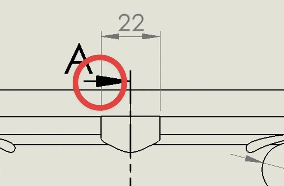

a greeting to all,
I am listing the view of a particular where I had to make a view in section... this gives me the letter and the reference arrow of the section line... and I'm going to hang on the reference lines of a quota... the situation is speculating in the lower part, so I have no alternative. . do you know how I can make the line stop at the overlapping point?
I checked and activated the options in interrupt lines under the tab association lines and checked in the options... But I didn't jump out.
Does anyone have a tip to give me?
I'm sorry.
You can't stop the quota line.
or fix the size of the arrow, which seems too cough to me, or bring the section line higher, cutting the quota, and move the "22" on one side.
quota break option exists, but I do not know if it works between quota and section line.
You should try
