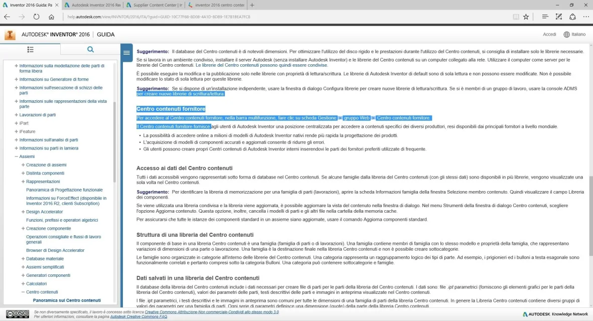

Since no one responds to the discussion that I started I tried to unleash in the inventor guide 2016 and I arrived to the point where I discovered it was possible to use the various bookcases present online (es traceparts) as inventor libraries (I usually downloaded what I needed).
the problem at this point arises when I find in the inventor guide that I can go directly to these libraries doing this:
1.webpI searched in all tabs but I find this connection. Does anyone know how to do that?
Thanks again to those who will answer me.
I don't know, but the supplier content center doesn't seem to exist anymore. according to me it refers to this:http://autodesk.partcommunity.com/portal/portal/autodesk/partcommunity/portal/autodesk#!prjpathinfo=

something however I managed to do also because the imagination and the spirit of adaptation to us italics we certainly do not miss. I still remain puzzled by the fact that on the inventor guide often and willingly there are writings of the incorrect steps and this I had noticed also in previous versions but at the time I had the online support while now the company for which I work decided that we can do without the online assistance!

true, the guide is not always updated to the release that one is using.
