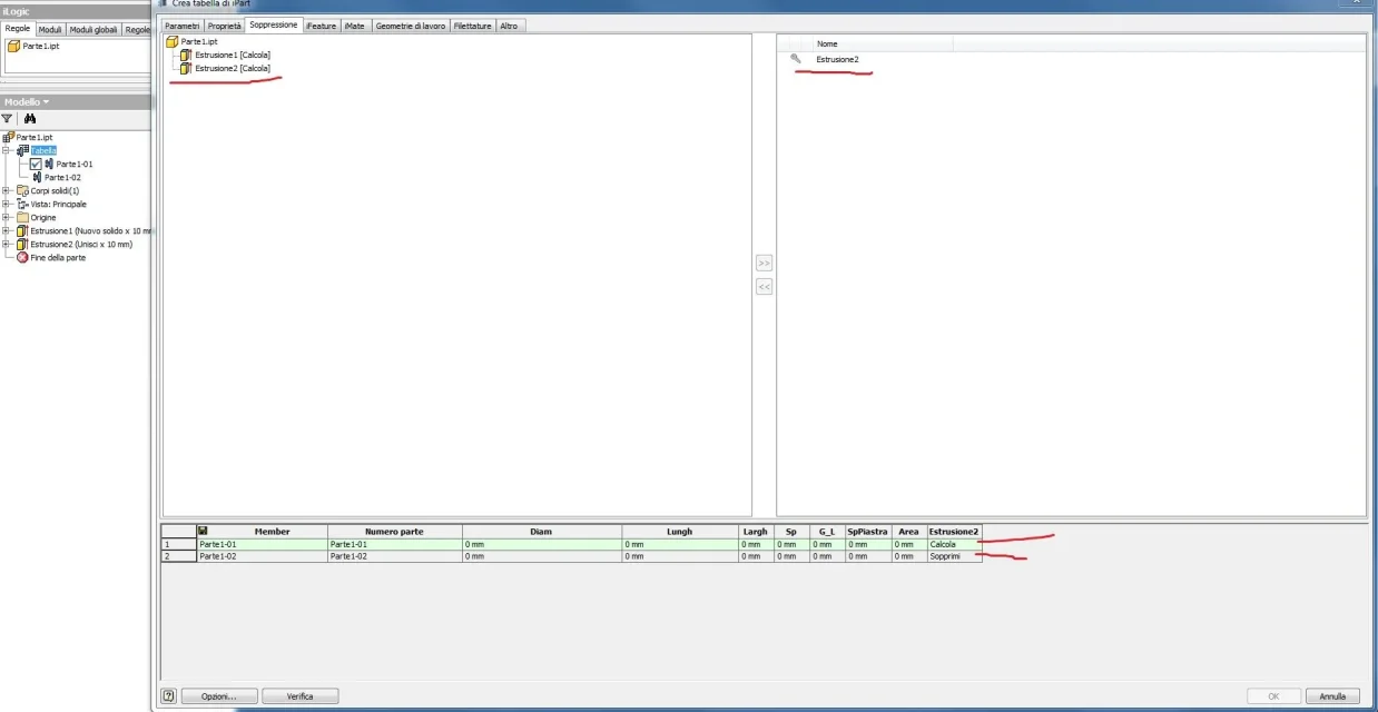

I have a problem that I would like to ask you:
on a part composed of various milling and drilling processes I would have the need to be able to create a configuration that excludes me these last (the holes) to be able then to use on the relative table. definitely creating an ipart and suppressing the holes I would solve everything but I never did it before.
So I created the ipart and on the table I saw that there is the section "sopression" but below I see a single line on which clicking on it proposes to me "insert line" and so I did.
highlighting the newly created line I activated the column "suppression" and I overwhelmed all the drilling processes I wanted to suppress, I clicked on "check", I saved and returned to the part where I saw on the browser the new table with both newly created configurations. the problem that on both configurations there are always all the processing, even those that (I thought) have suppressed during the compilation of the table.
Can someone tell me where I'm wrong?
I did a test, I attach the screen: See if you did this, it works for me.
Bye!

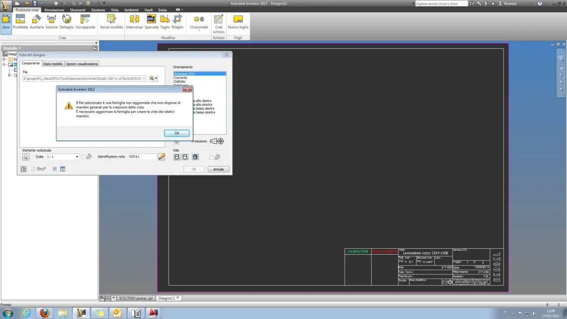

Okay, all right in the ipt, created the 2 configurations that work very well. the problem is in the idw when I go to insert the first view that gives me the message I attach.Problema idw.webp
-1- where were you wrong then?
-2- the error message communicates exactly what happens. you cannot place the view of that ipart version because that ipart version has not yet been computed and saved by inventor.
general and save the ipart, or if there are so many versions you can generate them all in a sub folder via single command (keyboard on the versions selected by browser)
