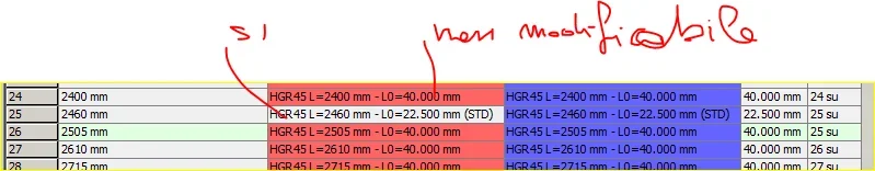

good evening to all, I have an ipt file that and an ipart, when I open the table to add configurations, I find 2 colored columns, 2 and blue and the custom field ok, the red colored prime and not all rows are colored in red, someone can tell me what it depends on and what it means that the column is red?? ? ? ?

Normally the red columns correspond to the "key" type structure-management items, "member" , "filename" "code" etc.
in your case you have entered a formatting of the field a little "do it"
hi eugenesis...discussed but I didn't understand..you could explain to me a little more in detail, "management structure" what would it be? ? ?
Hello, I have had red colored cells when the value is calculated by excel formulas in which errors were contained. set the formula coloring is back normal.
hi didinero, and just so, all cells that in the exel have a value coming from formulas, become red in the ipart table, and it is blocked the modification rightly, but it does not center anything the fact that there are errors, and only a visual reference that warns that the field is commanded by a formula in the excel file
