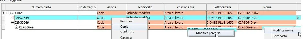

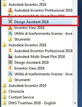

you can duplicate through "design assistant2 that you find in start all autodesk programsdesign assistant.webpallows you to open table 2d .idw, see its content and duplicate everything in it, 2presentation" includeddesign assistant2.webp
