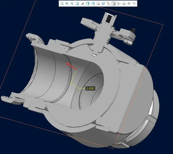

this is the resultant part of the shrinkwarp that then saves in step that then creates problems with some.. .

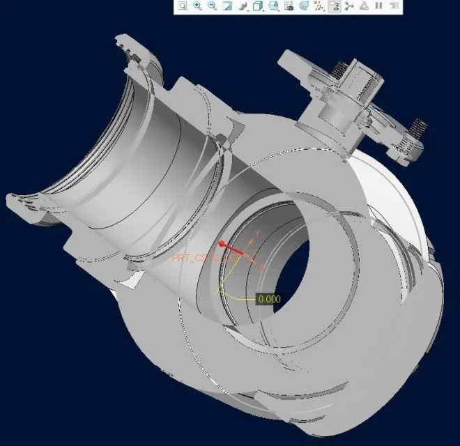

but this is the one with the boleans that I have not yet tested with anyone.
this exported in step and reimported as together?, does it work?
try for example to suppress the internal parts and then export.
...wait... I have the assembling of several parts, I do with the boleans the union on a part that then I open and save in step. I do not know if I can suppress parts but I think it is sufficent not to include them in the union but I must try Monday because now I can not.
