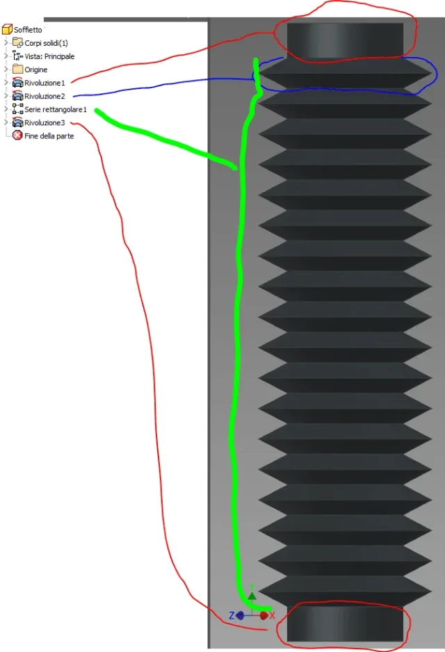

I take this thread back because I needed another bellow and I searched in the old messages to refresh my ideas on how to proceed.
I created it as part (not sheet), taking cue from the previous post of tarkus.
instead of using only one sketch (and only one revolution) I built it in four steps; I attach an exemplary image, if it were not clear to tell and explain better.

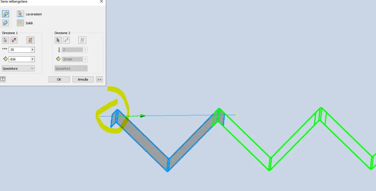

draws the first "v" with also raying and make series of processing, then final and initial curve cuts ...
1626438854610.pngI put a radius 6 but you have to know the thickness
1626439028622.pngyou cut the part then in excess simple and fast
