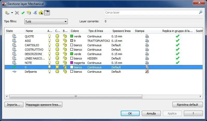

I have a layer with blocks with retinals. the layer turns on and off normally but when I turn it off and launch a print some of these retini print the same.
I checked inside the block and the nets are correctly on the aforementioned layer.
How come this anomaly in print?

Maybe you've already tried, but if instead of turning it off you tell him not to print it from the layer management?
see image attached. . .

deactivating printing from layer management works, i.e. not printing.
