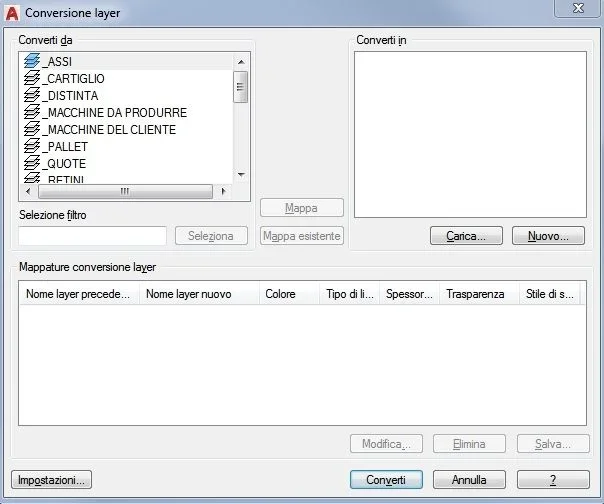

if on designs are many, you can use the function within autocad that is called "conversion layer"
card manage group standard cad conversion layerconversione layer.webpor configure standard
this, if it is a native design of autocad, while in inventor you have to have a norm under the name of the customer pointing to a "default of the object"
always with the customer's name in which it attaches styles and layers with a unique name, obviously different to those of the date design.
save the idw model and that is the correct environment x that customer.
