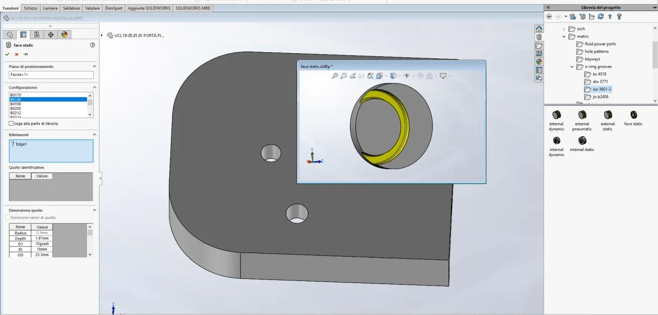

in practice I have to make a home for o-ring,
I use library functions, I choose iso 3601, type of home "face static",

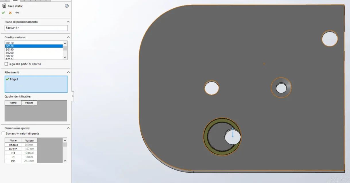

after choosing the o-ring I need (in my case b0180), I see the non-concentric seat with the hole on my model,
even after choosing the edge of the hole where the o-ring has to go, I see the decentralized seat compared to the hole.Cattura2.webpCattura3.webpWhere am I wrong? or is there a problem with library functions?
thanks to all
the edge of the hole (edge) is selected correctly?
tonight I take a look at the function
Hello Massive
Yes the edge is selected correctly, it seems strange that already the preview let me see a decentralized quarry
I checked and it's the library function the problem. if you expand it you will see that the cutting sketch in revolution is underdefinite because the bond of the axis is missing which then is shot in the sbrisolona way.
what you have to do is open the library function (right-click on the bread task>open) and seize it by binding the axis to the origin and save
thanks massive, I had tried to create a hole axis and to bind the sketch to the axis I had created, so I had solved for this case.
with your suggestion, do I resolve permanently or do I have to do this correction every time?
Thanks again
I have already written it, you have to correct the basic library function
