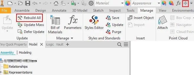

try to make a "rebuild all" and see if a red crust appears
