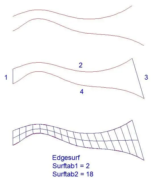

other variant
connect the ends of the 3 splines to form 4 sides.
use edgedurf with surftab1=2 and surftab2=18, selecting clockwise (or anti-clockwise) the 4 sides, starting from one of the 2 straight links.
greetings to all
is logical that joseph refers to _edgesurf e non a edgedurf.
