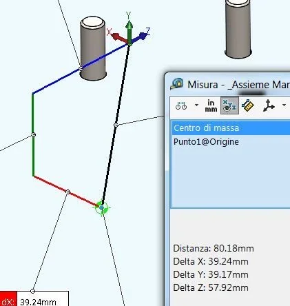

Good morning to all, I need to know the position of the center of my own together with respect to the origin.
I have selected to evaluate -> mass properties and result in the coordinates:
centr1.webpwhile if I try to measure between mass center and origin, these other quotas are shown:
centr2.webpWhere am I wrong? Thank you very much
I found the hippo: I had an element of hidden and not suppressed assemblies.
therefore the property measure considers only the visible elements (active) at the click of the command;
the mass center created and measured instead considers both active and hidden elements (motive of the measurement gap). suppressing the component, the coordinates are identical to the previous command.
the suppressed elements instead are excluded from both.
