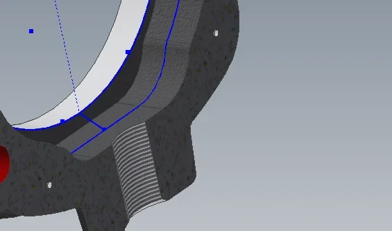

How would you close the area you see in the annex?Loft.webpI'm trying with a loft but uselessly...
My problem is that the hole must remain, I must "connect" the edge of the hole with the inner part that is shaped and I do not jump out.

does not loft do it (as surface)?
then there should be a tool (such as sculpt or merge) that should create the solid from the surface.
If I could train the part, I'd play it a little bit.
greetings
Thank you very much.
I didn't think of lofting as a surface and joining the solid.
I don't have the habit of these commands.
Thanks again
