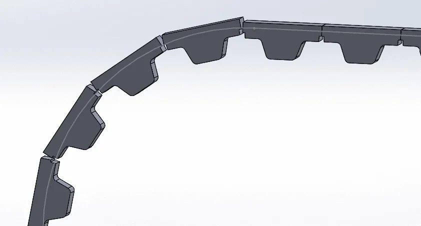

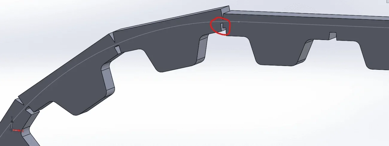

I extrude a tooth and problems begin when I repeat along the curve.
you dare to repeat the inclusive tooth of band.
you must shape the band for its own facts and extrude, then repeat, the only shaped tooth
I don't think I understand what you mean.

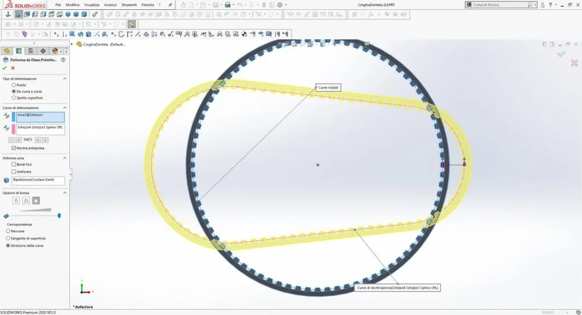

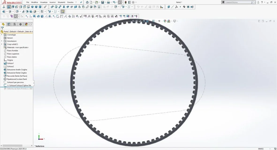

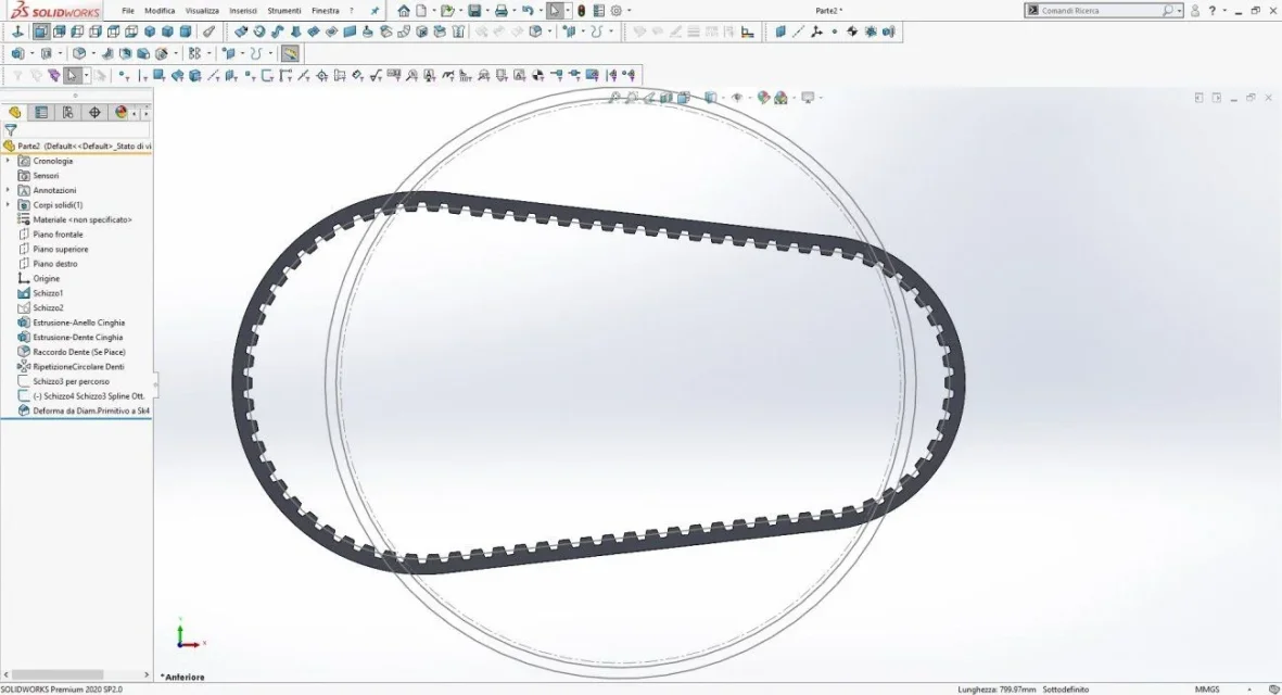

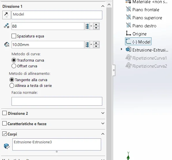

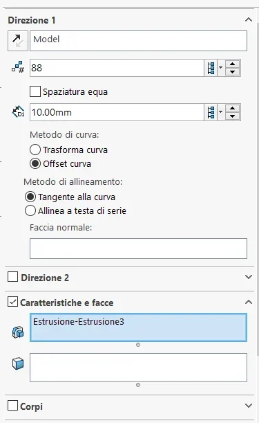

I reread the command guide and solved by changing the offset curve method, now I can repeat the function (in this way on the straight stroke the body is unique).
