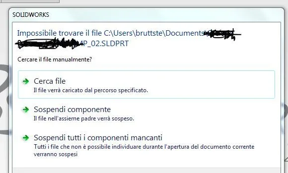

It's the first time I've had such a problem and I'd like your help.
I resumed a project that I had abandoned, only that on an external hd I had the file of a necessary part and unfortunately this hd has guastato, and now when I open the file of the project sw asks me from where to load the component because it does not find it anymore, and to continue I have to jump it.
in these cases what should be done?
the names in the photos have been deleted as they report a trademark owner!

Unfortunately I had to remake another, using the sketches of the suspended component, which are still visible, and then I saved it as a body.
but the message appears to me the same, can it depend on the father functions?
Did you delete the imported part that can't load? if you don't do that message will always appear
I apologize for the banal question!
I mean, should you just delete the part that can't load?
But I don't understand why every time I save a body, held maybe by division, or combined by subtraction etc., however I always get connected to the part we say it does as "father".
how do you save it as an independent body?
right button on the import function or on the body in the new part, lists references> interrupt everything. is an irreversible operation; interrupted references can no longer be restored
