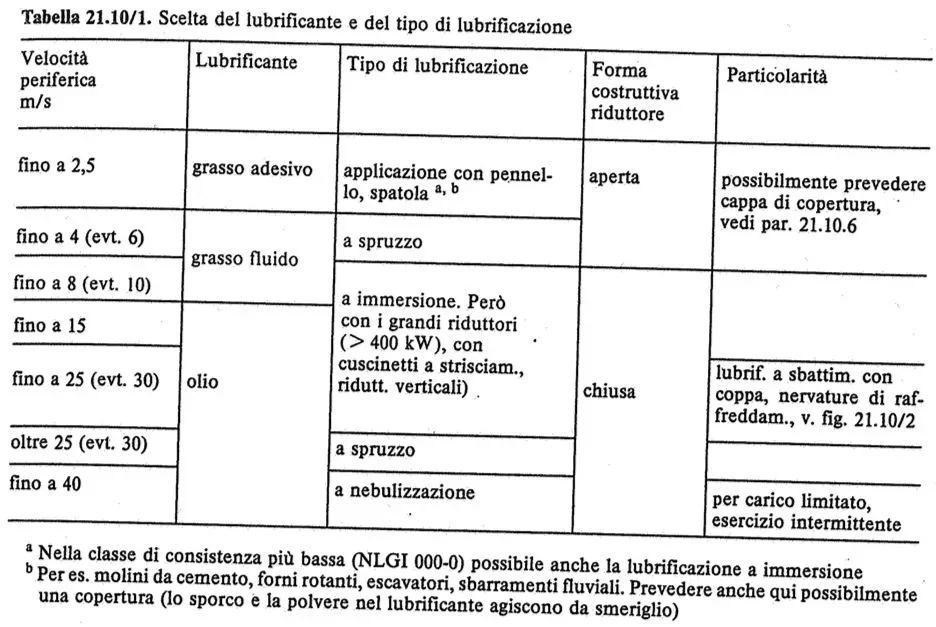

you can recommend a text that tells me the fields and speeds - recommended admissible pressures for any type of lubrication cited
the subdivision of your lubrication is given by the peripheral speed of the gears.Screenshot_20201018_161221.webpon niemann - elements of machines volume 2 is treated in depth the concept of lubrication, flow rates and everything else.
