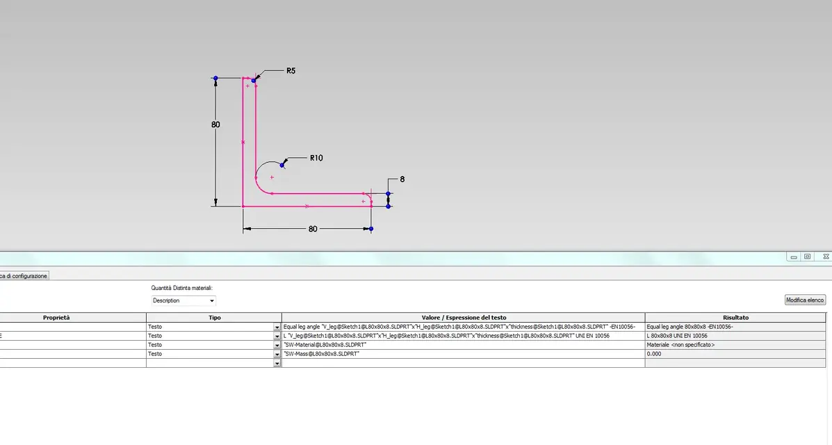

the thing would be this:
I have my weldment profile libraries that I want to update in the properties of the file that will appear in the separate cut, because besides the description in Italian there is also the description in English, but I may have the need to change a description on all (for example if a customer requires me that on the profile description there are the en instead of the one) to create a whole new profile library (and then it requires to specify in which directory you want to save the new macro files).
Currently as a solution I thought I could do so: for some normalized profiles I have a "parent" library file with n configurations that could be useful in regenerating all the above mentioned files with the help of the macro "config ripper" that allego, but the very useful macro regenerates part files and not library files.
