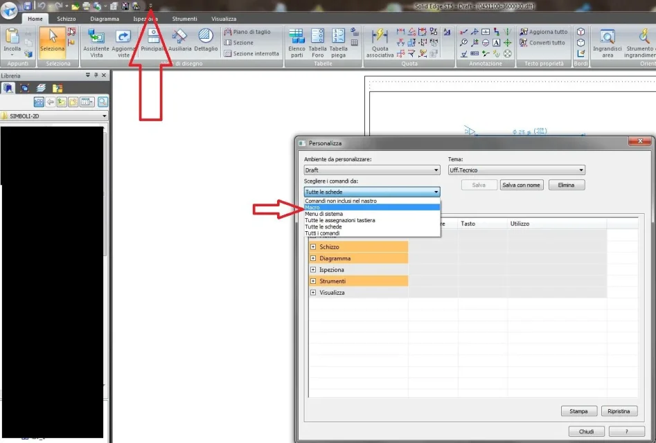

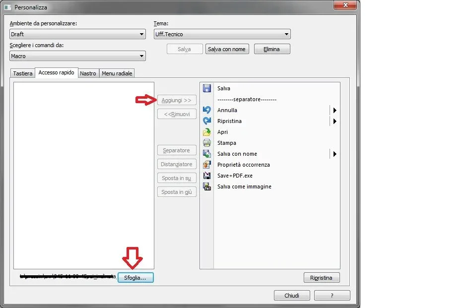

the macros you had on the v20 you will have installed them and then recalled by the cad by adding the command icon, or only "fishing" the link to the executable from solid edge.
on the st5 do the same thing, install the macros on the laptop, or cover the executable from pc to notebook.
from open st5 go on customization, quick access, choose macro and look for the path where the macro is located and add it to the horizontal bar
