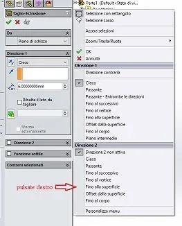

However I noticed that at active property manager by clicking the right button on the graphic area shows the context menu with the term conditions, maybe it can streamline the choices instead of clicking on the drop-down menuImmagine.webp
