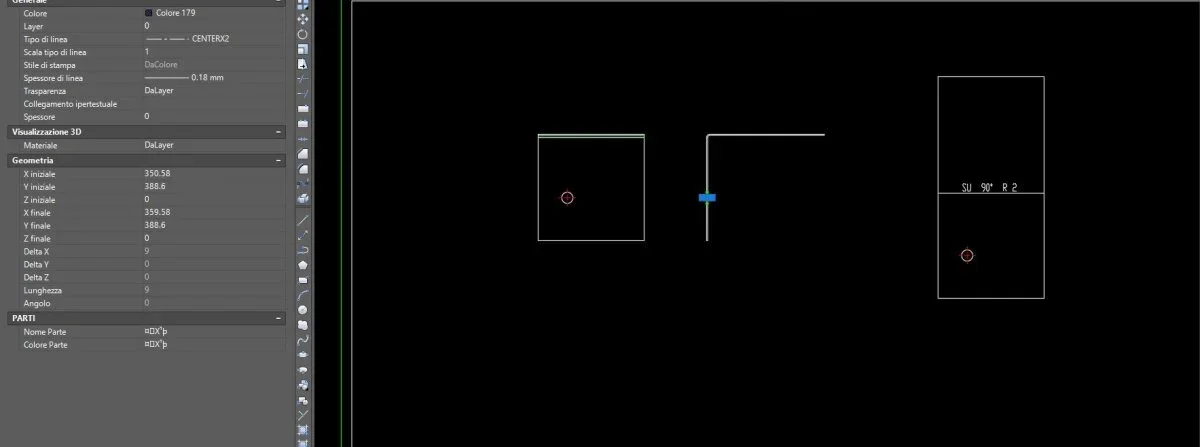

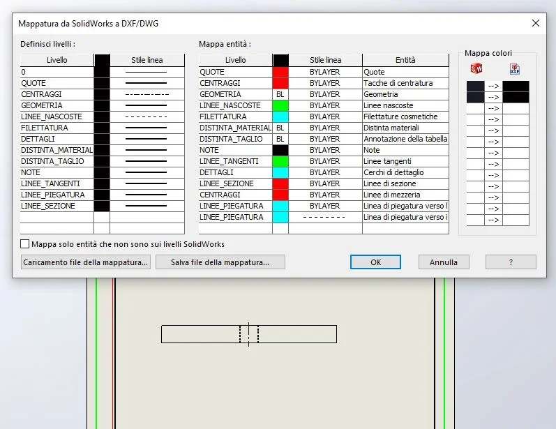

enriazzo99 Guest Apr 13, 2023 #1 Good morning to all, I have two problems with dwg mapping: I can't understand why mid-range lines don't go into the correct layer and color assigned. I would like to know if there is a possibility to color and give a character to the bending lines up and down Thank you very much in advance

enriazzo99 Guest Apr 14, 2023 #2 Good morning, everyone. After a thousand tests I found out to be a solidworks version problem, updating to 2023 solved by itself. Thank you.
