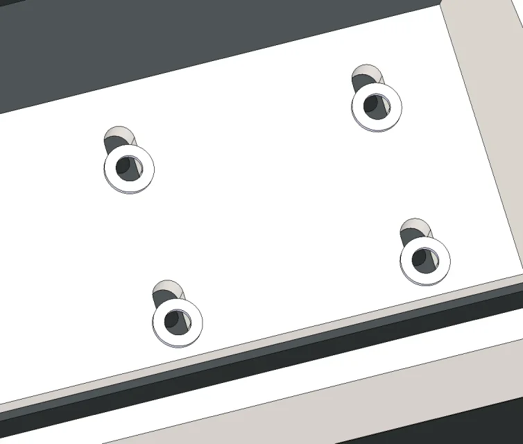

Good morning to all, I don't know if the question is trivial anyway I will ask you the same and you will forgive me.
when I go to insert a washer or a nut through uniworks to fix a profile asolate than a hole, I always have to perform two couplings. basically the automatic coupling "concentric-complanar", selects me or the center of the circle of the asola and the plane of the asola (the plan is fine, the center of the circle no) or the center of the hole and the plane of the hole (the center of the hole is fine the plane no). the correct solution obviously would be the center of the hole and the plan of the asola.. .
said that, the only solution is that I do, i.e. delete a couple and create one again or is there a smarter road that makes me the correct coupling to the first hook?
copy image of the problem
I am very doubtful about this possibility.
the asola coupling is a mechanical coupling that needs the selection of faces and not edges such as concentric and coincidence
if you open your uniworks element you will see that it has a mathematical directory that serves to make automatic couplings; among those available you will not rightly find the pairing asola.
rightly because otherwise that part would only work with sunshades and not with normal holes
