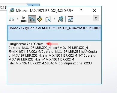

MARCOC Guest Apr 11, 2018 #1 hello to all, I open a file and use the measure command, but instead of displaying my size view as from image Where does that approach depend? ? cats thousand
MassiVonWeizen Guest Apr 11, 2018 #2 means that the measure is set in scientific method. click on in/mm and system settings
