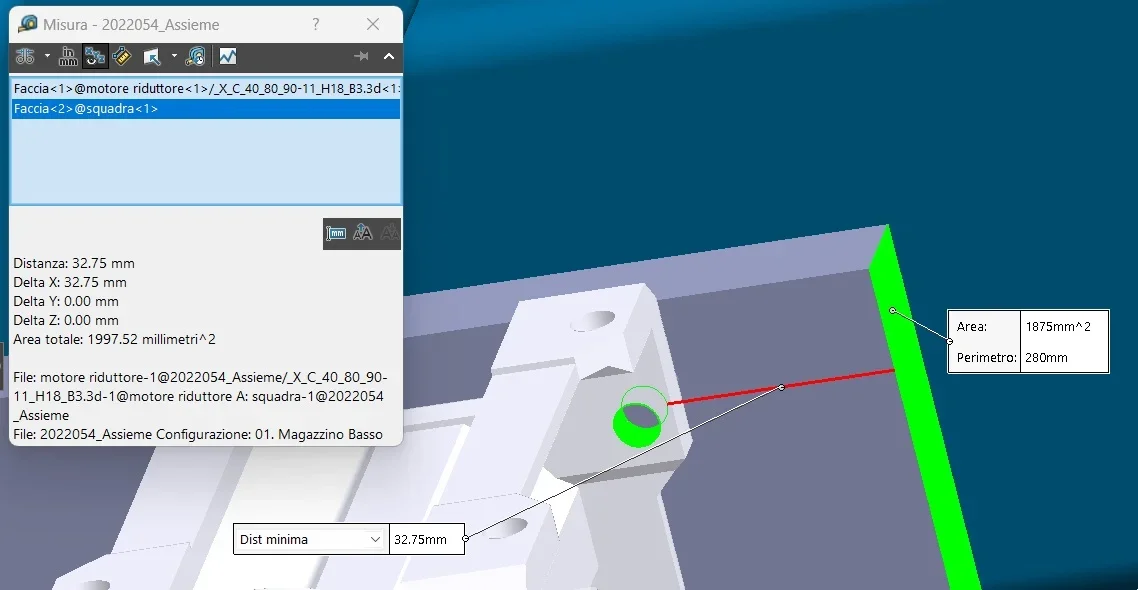

I can't understand why if I take the measurement of distances of some objects and then I carry them such as in the sketches they don't match.

because in the measuring instrument take the quota outside the hole, while in the sketch go to quota the hole center. changes the measurement method on the first icon on the top left.
