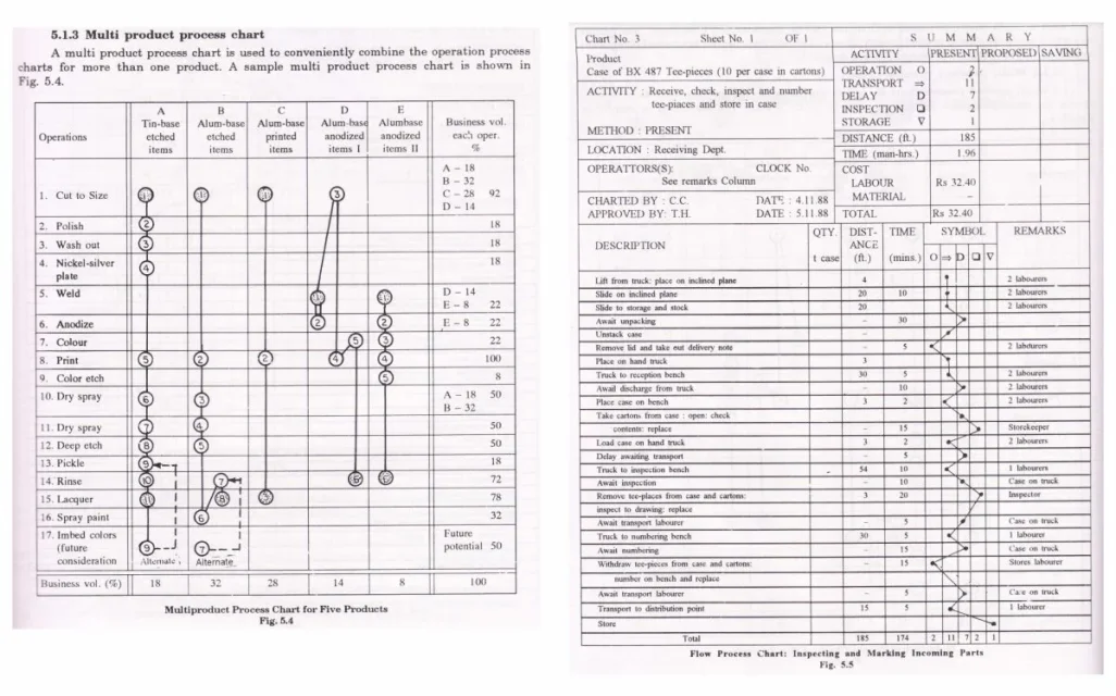

I thought I'd fix it like this:
1) from tab1 take from min/u values with appropriate calculations to turn it into u/year. (therefore doing the reciprocal and multiplying for 6500 h/year). These values I dedicate them with cp. to find then the operating units u, I divide the total quantities of the warehouses of each product q for the correspondent cp. finally elevated the corresponding u and I find the result of the second question of the first exercise. in the last question I find the pallets/year for all products and high those entering and leaving b. the thing I don't understand is those various warehouses m1 m2 m3 etc. I don't need anything, except to sum them and find q?
as required by the exercise you must first graphically represent the cycles of processing and transport through the "multi product process chart" (see example attached); on this you will calculate the necessary operating units according to the time required for each technological and product cycle.
when you have produced this document, we can expose our evaluations.
in this exercise the four sorting warehouses serve to have the overall volume of production for the calculation of demand 2.
in the third question it is necessary to evaluate the intensity of traffic of the department b referring to a previous exercise; it is a matter of understanding whether by department b is intended the sorting warehouse b mentioned in the text of exercise 2 for which you already have the necessary data, or other.
I did the mppc, but then I considered the production capacity and the total annual quantities to find the operating units. I still think it's right. I'll send what I did tomorrow. for the part of rectangular distances etc. I should put the weights in m2 is 0 and the rest I have to do it with w (weights) where d is the rectangular distance of the warehouses from m2?
