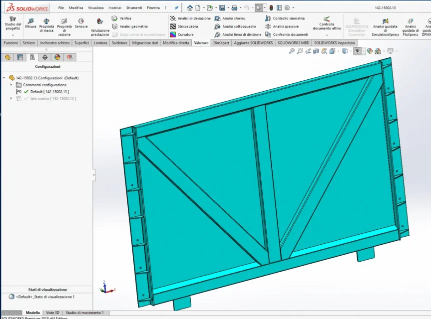

Hello everyone,
I have the following question.
having a model with two different configurations (different height) and having made the table of the first configuration, I ask it is possible to copy the table in a new sheet and make the same update to the other configuration? so as to avoid remaking the table as it would be exactly identical to the other except for the height of the model.
Thank you all in advance for the answers given and good evening.1528389156434.webp
copy the table and in the main view change the configuration
right button on the sheet tab1> copy
right button on the sheet tab1> paste and asks you in what position to copy the sheet (in the same way as excel)
thanks massive, but is there a way to change the configuration automatically even in the table?
