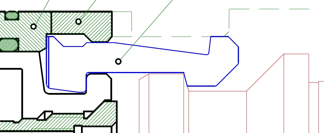

I am trying to make solidworks run a physically valid path of the opening stroke of this pliers Cattura.webpI have the assembly ready, but I don't know what constraints to impose

two explanations about the operation and an image of the open position you could well put them?
let us go of imagination: the clamp is the blue part that opens turning upwards when the upper group moves to the left, thus freeing the red part.
we come to the constraints: I would impose a rotation axis, impose an angular limit to be associated with a rack-type bond with the moving part to open the clamp. The cam bond could also help.
