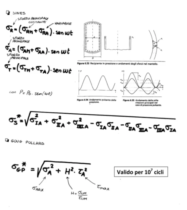

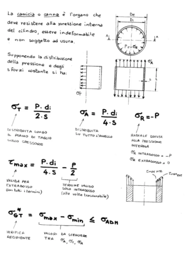

5 years of mechanical engineering and this definition never heard. or is new or is too old. First of all, if I have a flender moment, I will have a single sigma. I don't see why there should be more than one. the two proportional sigma (one double of the other) are due to the internal pressure to the tube in the figure. are mariot sigma, axial and circumferential, the first half of the second
the fact that the torque is alternating or constant has nothing to do with the aforementioned sigma. if it is constant does not have an alternating component so it has no effect on fatigue. if it is alternating you will combine it somehow with other components of effort (gough-pollard crackers, sines) and you get an equivalent effort to compare with the fatigue limit or to insert in the woeller curve
What's written on your book is a little ambiguous. on the tube that is symmetric does not serve all those menades.
normally you can look for more or other things and using a woheler diagram consider the cumulative damage of the various stresses.
that a pressure tube has tensions as an attachment. then if you add torsion or bending there are definitely additional tensions you need to consider.
then with sinesis you do the test with difficulty identifying the plan where the stresses that compose are maximum. clearly if the actions and therefore the tensions are constant is one thing, if they are buttons or rotating is quite different.
