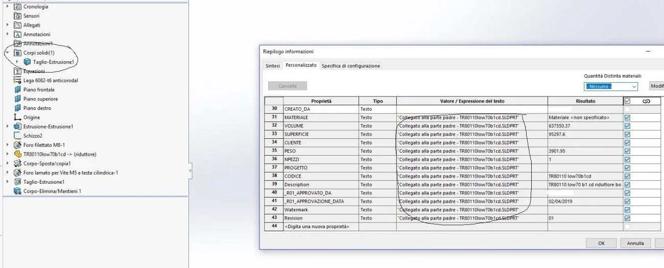

I have a problem with a multibody part that I don't use most of the axes, except for welds.
I created a plate that should be interfaced to a reducer; I put the reducer inside the part to take the relays of the fixing holes; until here everything ok but when I make the table the material of the plate is not connected; hoh controlled in the properties of the document and tells me that the material is connected to the parent part that in this case is the reducer that having different materials tells me that the material is not specified. How do you manage this? allego file hi

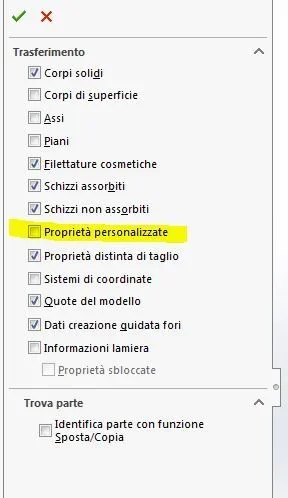

if you create a part and insert to the reducer as a derivative part commands the material of the part and the properties of the reducer you will find in the possible separation of cut.you can find escamotage how to keep the only plate eliminating (function deletes bodies) the rest, or giving the reducer, if commercial, the material of the plate.. .

I tried to remove the bodies but nothing changes??? ? is normal
when inserting the part removes the tick to custom properties

It happens. however the method is the one reported in post #6; you can do it even after inserting the part by right-clicking on the part or function and editing function
