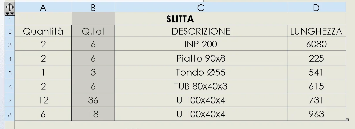

for production needs I need to get in the cutting distinction for welds directly from table in solidworks a field that tells me by inserting the amount of structures identical the number of overall cuts to produce.
igo image
Create a new columns, insert an equation whose multiply the amount cell for the structure cell
But if I save the table with the equation and insert it again the equation disappears.
What am I wrong?
I tried with the column but did not activate the equation key then I put them in each cell.prova.webp

I am also trying but I have not yet been able to insert the equation in the standard cutting table at the end but what interests and give the carpentry the overall quantities in a more automatic and flexible way possible
But I think it's a widespread problem, someone else faced it?
reassurance: I want the quantities in the cutting range to be modified according to the quantity of pieces (multi body) to be produced so that in the workshop they should not multiply the quantities per piece by the number of pieces.
I would like the operation to happen automatically and directly in solid works (I prefer not to export to excell), however I accept any advice.

the problem has been dealt with, but there is no solution to the problem in the sense that sw does not multiply the bodies contained in a general set. this at least without pdm, with a pdm maybe you succeed, but I don't know how to tell you since I don't have any.
I remember that jenuary had made a macro, but I could be confused.
it should be said that if distinct materials and cutting distinct are two very different things that require a self-management
a possibility could be to use instead of separate cutting the distinct materials with re-entry.
this would allow you to use the equation in column header and the properties of the file in which to insert, with macro or other artiphyte, the amount of parts to perform thus facilitating multiplication.
absolutely are different yes. However, it is always necessary to intervene in manuals, because automatically you cannot.
with jenuary we had just begun to process something but since it is not a simple macro but to enter the meanders of the sw programming, I desisted x that I could not afford the expense for the elaboration of the program.
I had found the escamotage to propagate the quantities through the distinct together, but not if how many problems it brings behind.
