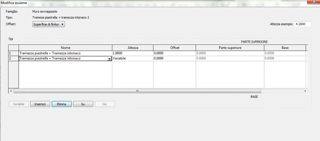

Good morning.
I would need to have an answer about the overlapping walls (walls in which not layers of stratigraphy are added but different walls between them).
I am following a book in which he tells me that, once entered the above wall option I should find the type of hustleness - it is plaster and hustleness - piastelle, in my file there is only tramcity more plaster tiles.
Muro sovrapposto.webpwaiting for a kind match,
cordial greetings.
the list of voices between the choices of the overlapping wall coincides with the list of the base walls. You obviously don't have the basic walls as shown in the book
my question was "are there no templates suitable for those types of wall? "
