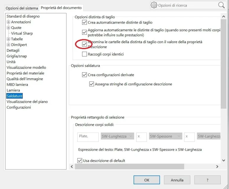

I confirm what is suggested on the creation of multibody units, that is, that a body is exported per folder (on the export name I do not see solutions at the moment).
you have to pay attention to the flags (see image)
from the "saving" properties of the feature manager add a line that is called description but in the field then what do I write to us? because whatever I go to write I will find it identical in every line
but sorry, you enter a common value to all folders and then the progressive one by editing the folder? If so, you're wrong.
I thought you understood that the description should be compiled for each individual folder. ie I in welds insert the description item and the drawing value then go into the properties of the first folder of the cut distinction, I go into the property synthesis tab, place me on the description item and add the progressive on all folders (see picture)
ok I have tried to save the bodies together, I had already done it yesterday (putting the check from you indicated) but foolishly I did not realize that it would insert the same part several times already with the name that I want (if I give it to the body before saving the bodies), so then I can generate a distinct materials and easily export everything in step with the task planning. That's cool.
It is enough to hide or eliminate the climbers if I want to make a partial export maybe even excluding them from the cutting distinction so being reported from the property window I can easily fill the fields without confusing.
ok no, in fact I did not understand, at this point I will put by hand the names of the profiles, but it can be well, I gain time after in phase of rescue bodies.

I hope this is the right topic.
I would like to know if even to you with the option of rename the folders of the cut distinction automatically, in the part, adds the symbols <1>. then you see in column table name distinct cut element. I could delete them by renameing the column, but it wouldn't be automatic, but manual.
Does anyone know how to eliminate them please?
