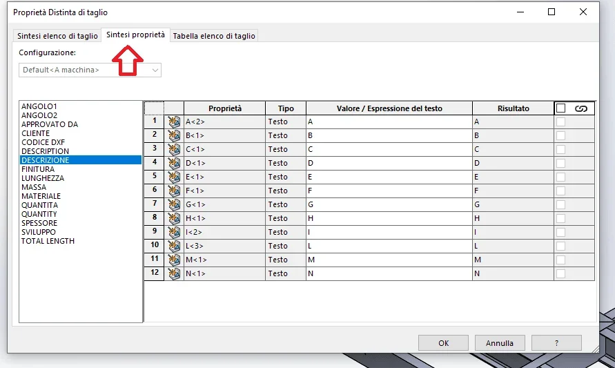

I confirm what is suggested on the creation of multibody units, that is, that a body is exported per folder (on the export name I do not see solutions at the moment).
you have to pay attention to the flags (see image)
I thought you understood that the description should be compiled for each individual folder. ie I in welds insert the description item and the drawing value then go into the properties of the first folder of the cut distinction, I go into the property synthesis tab, place me on the description item and add the progressive on all folders (see picture)
but sorry, you enter a common value to all folders and then the progressive one by editing the folder? If so, you're wrong.from the "saving" properties of the feature manager add a line that is called description but in the field then what do I write to us? because whatever I go to write I will find it identical in every line
